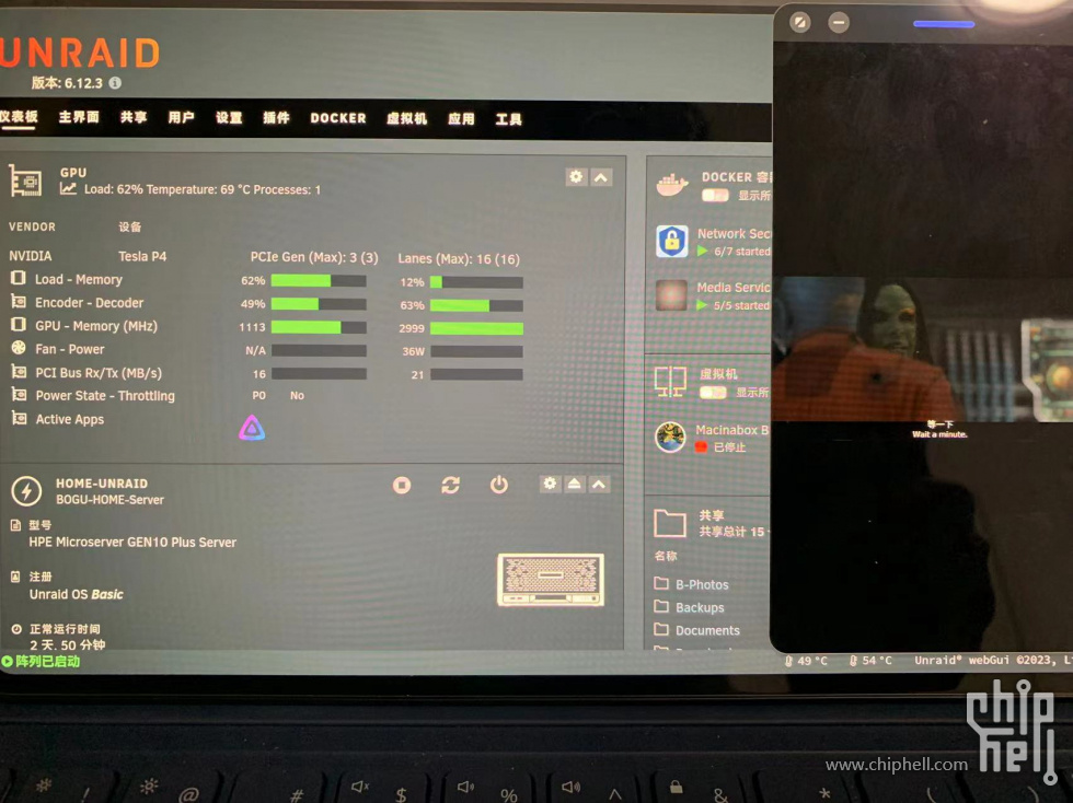

根据大家的建议,淘宝400+入了台TeslaP4 。几乎全新,无尘,可能之前是在无尘机房服役过,不知道后来有没有水洗过。
功耗
gen10 Plus 上机实测,不开节能模式,25W左右,jellyfin解码大概在38W左右,在计划脚本里加个自动开启节能,设置每小时自动允许,待机功耗可以下降到7W。
  1. #!/bin/bash
  2. # check for driver
  3. command -v nvidia-smi &> /dev/null || { echo >&2 "nvidia driver is not installed you will need to install this from community applications ... exiting."; exit 1; }
  4. echo "Nvidia drivers are installed"
  5. echo
  6. echo "I can see these Nvidia gpus in your server"
  7. echo
  8. nvidia-smi --list-gpus
  9. echo
  10. echo "-------------------------------------------------------------"
  11. # set persistence mode for gpus ( When persistence mode is enabled the NVIDIA driver remains loaded even when no active processes,
  12. # stops modules being unloaded therefore stops settings changing when modules are reloaded
  13. nvidia-smi --persistence-mode=1
  14. #query power state
  15. gpu_pstate=$(nvidia-smi --query-gpu="pstate" --format=csv,noheader);
  16. #query running processes by pid using gpu
  17. gpupid=$(nvidia-smi --query-compute-apps="pid" --format=csv,noheader);
  18. #check if pstate is zero and no processes are running by checking if any pid is in string
  19. if [ "$gpu_pstate" == "P0" ] && [ -z "$gpupid" ]; then
  20. echo "No pid in string so no processes are running"
  21. fuser -kv /dev/nvidia*
  22. echo "Power state is"
  23. echo "$gpu_pstate" # show what power state is
  24. else
  25. echo "Power state is"
  26. echo "$gpu_pstate" # show what power state is
  27. fi
  28. echo
  29. echo "-------------------------------------------------------------"
  30. echo
  31. echo "Power draw is now"
  32. # Check current power draw of GPU
  33. nvidia-smi --query-gpu=power.draw --format=csv
  34. exit
复制代码

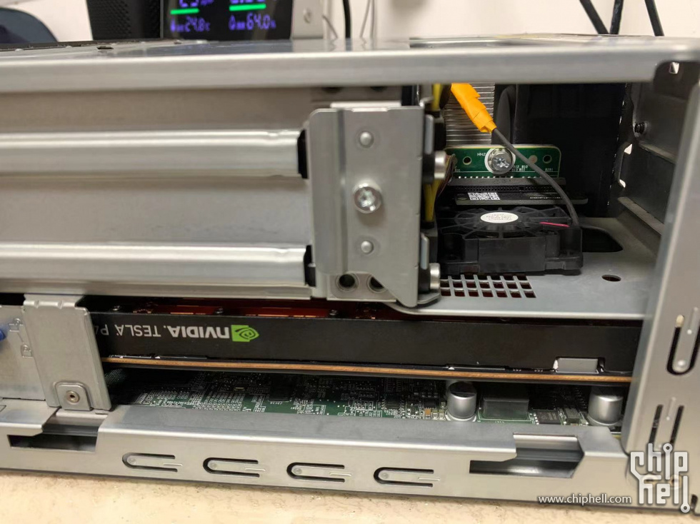

散热
!!!!!!!!!!一定要拆掉显卡盖版,露出散热铜片!!!!!!!!!
目前测试,单纯靠机箱风扇,完全压住不,显卡一运行,温度直接飙升到70°以上,然后机箱风扇就疯狂转。。
初步方案是在PDD上几块钱买一个小的散热风扇,固定在显卡铜片上方,有一个小空间可以安装,但是找了半天主板上没地方取电,只能用USB口取。
通过图中的小孔,往显卡上吹气,能散热,但不理想
Jellyfin转码测试,温度在70°~80°之间

功耗没问题,但是温度压不住,还得加装小风扇
