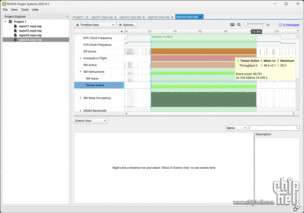

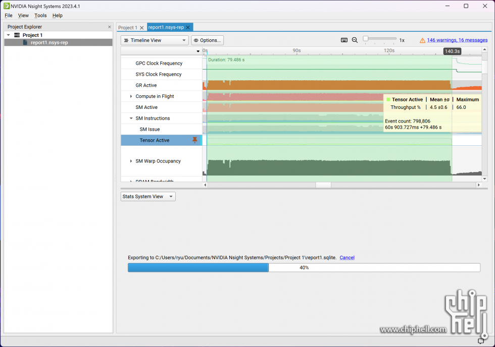

最近看到说老黄为了绕过封锁可以阉割占据大部分算力的tensor core而且不影响游戏玩家的体验, 贴吧的柯基和ati群的求秒帝都
说过玩游戏时的DLSS不会使用太多tensor core算力, 好奇之心就下了Nvidia官方工具nsight测了下4070ti几个游戏的表现,目前看下来
平均只有1%不到的使用(但瞬间最大会有40-70%不等的peak utilization,这一点跟国外论坛的数据好像不一样).
图中指数含义:
SM Issue: SM instructions issue rate. Each SM can issue 4 instructions per cycle(1instruction/SMSP/cycle).
Tensor Active: Cycles the tensor pipe is active.
仙剑7: 4k, DLSS质量,光追中,雪山入口处
巫师3: 4k, DLSS质量,画面全高, 光追全开,帧生成开启, 百果园野外.

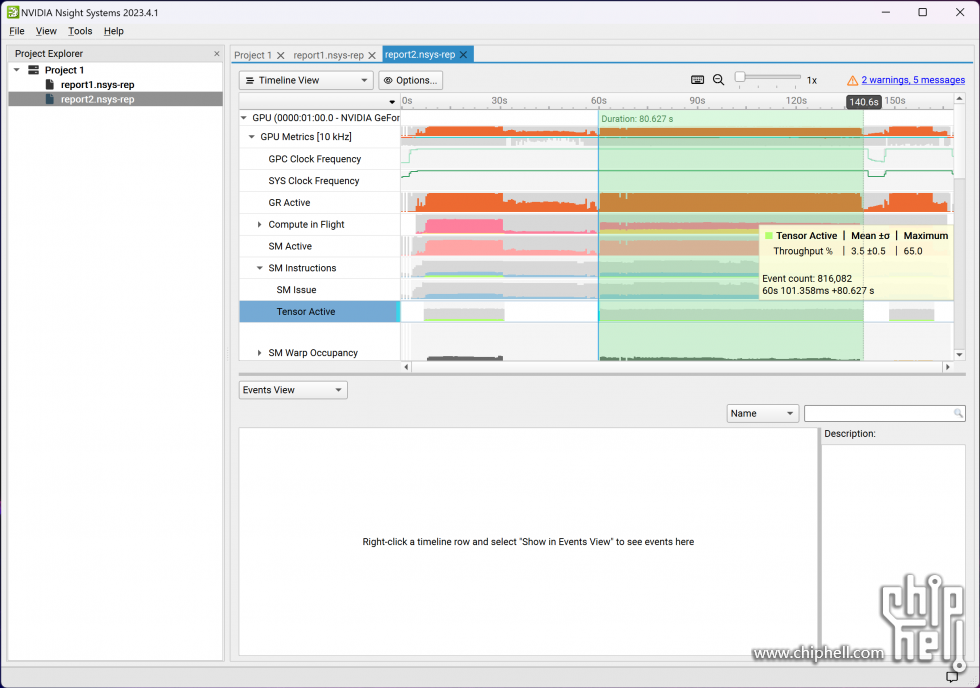

发表于 2023-12-1 22:48 | 显示全部楼层
2077的我帮楼主测了。
4090FE,4K,画面选项除了动态模糊和垂直同步全部拉满,包括路径追踪。
第一张没开帧生成,第二张开了,居然比没开对tensor的占用还低。
我看不懂这个tensor active。仅供参考。
场景就是自带benchmark。
作为对比,跑了一个相对density的AI程序。
勉强达到50%,我觉得已经很高了,因为还要等数据sync。
占用是一条直线是因为采样的原因,并不是占用是平稳的。

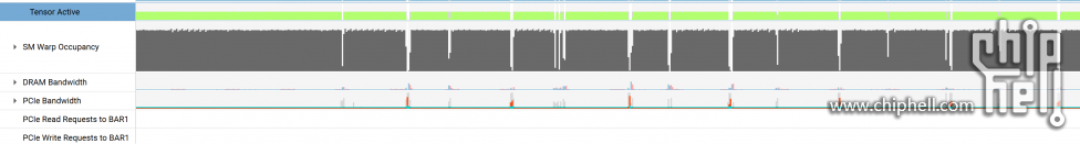

下面是把采样率提高到200K。
profiling捕捉到了更多细节,所以对误差棒做了修正。
第二张图是对图表放大后的结果。可以看到tensor core空闲的时候都是在做pcie和dram的交换。

我也不是专业的图形学编程工作者,按nvidia开发者论坛官方人员的说法是这样的:
Cycles Active
Pipeline utilization based on the number of cycles the pipeline was active. This takes the rates of different instructions executing on the pipeline into account. For an instruction requiring 4 cycles to complete execution, the counter is increased by 1 for 4 cycles.
Inst Executed
Pipeline utilization based on the number of executed instructions. This does not account for any variation in instruction latencies for this pipeline. For an instruction requiring 4 cycles to complete execution, the counter is increased by 1 only.
As you can maybe see from the descriptions, inst_executed only looks at how many instructions are issued, but not at their latencies. If the instruction has non-negligible latency, the metric will never reach 100%. Cycles active on the other hand takes this into account. Seeing both side-by-side is ideal, as it indicates not only how much the pipeline is utilized, but also if it’s utilized by many short and few long instructions.
我猜大概流程可能是这样: 游戏引擎渲染管线加入DLSS post-processing, DLSS实现逻辑在nvngx_dlss.dll下, 真正游戏运行时执行到后处理时dll中的代码经CPU发送到GPU前端解码后指令发送到后端SM scheduler(nv的架构有warp schedule但我不太懂), 这里的tensor active为4%应该意思就是只有4%的时钟周期里tensor core流水线是活跃的,其余都在空转, 至少这个值应该是跟tensor core利用率极度正相关.
