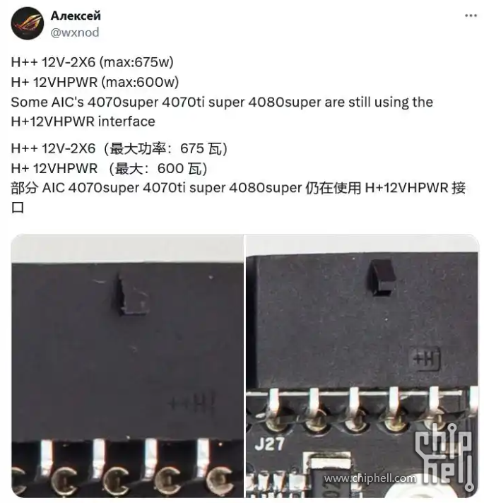

主要是5090出来时候有个H++接口的概念来,4090时代是H+接口,可能H++的冗余高点吧
转图

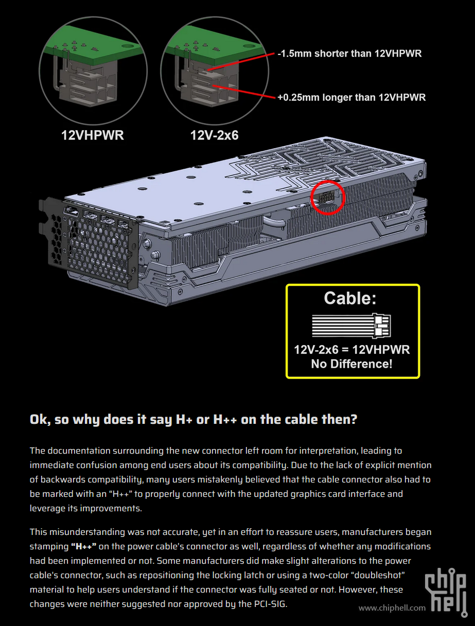

发表于 2025-6-20 11:34 | 显示全部楼层
What is the difference between 12VHPWR H+ and H ++?
H+ vs H++ on 12V-2x6 / 12VHPWR cables: What does it mean ...
What is the difference between H+ and H++? There is no difference when it comes to the cable. H+ refers to 12VHPWR, and H++ refers to 12V-2x6, and the differences between these two are only present on the GPU or PSU sockets, not the cable or it's connectors. There is no physical changes between on the cables
根据海盗旗的描述应该是指新显卡电源接口改了,和电源转接线无关。
