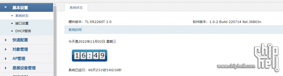

ER2260T,便宜大碗,我自己也在用,很稳
