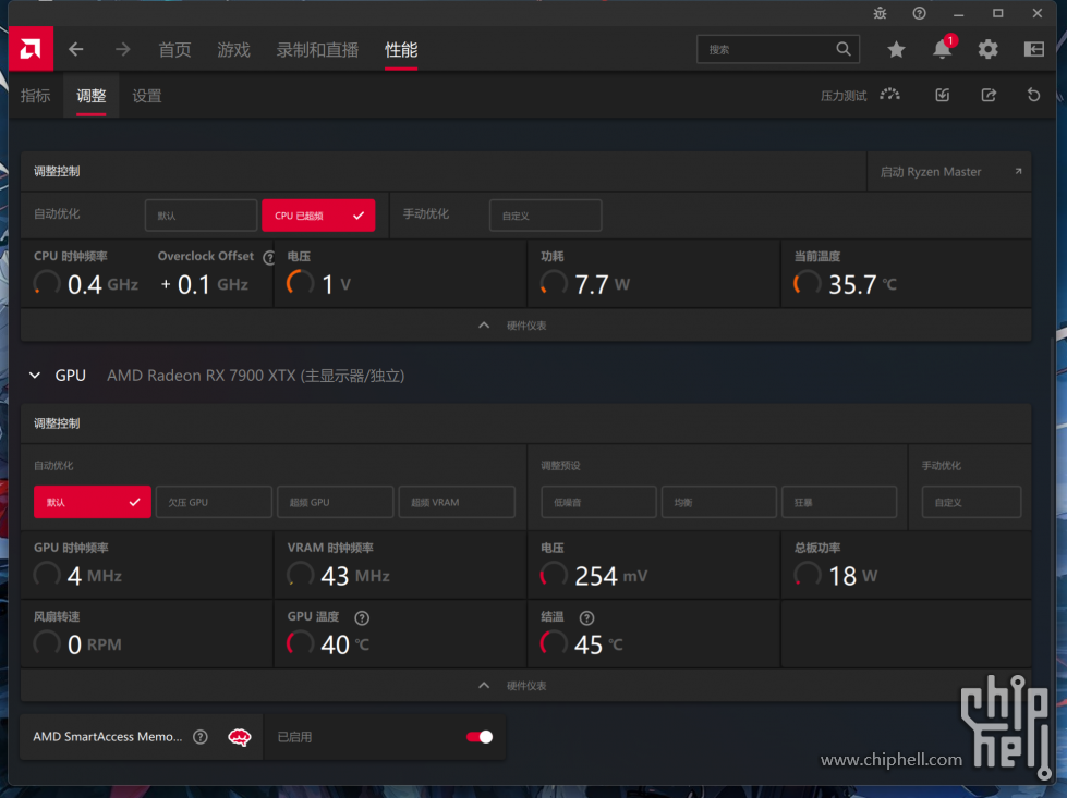

发表于 2023-6-28 11:29 | 显示全部楼层
ts02147823 发表于 2023-6-27 22:29
https://www.amd.com/en/support/kb/release-notes/rn-rad-win-23-10-01-41-vlk-extn
预览版驱动 好像修好 ...
的确好了很多,但是双屏还是100w
