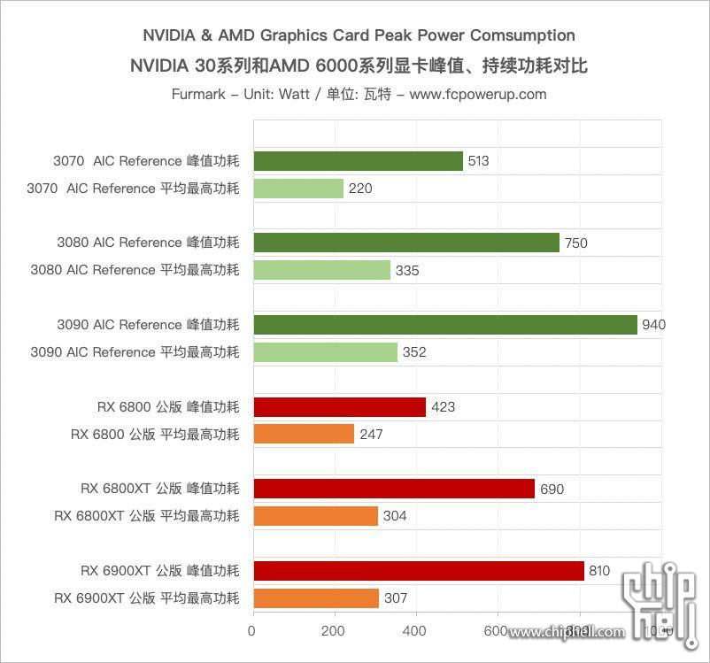

Scarlet〃 发表于 2023-7-26 10:44
6900XT的瞬时功耗也并不低,只不过是被当时更夸张的3090盖住了风头 可以单纯的理解为amd并没有对瞬时功耗做 ...
赶上矿潮,绝大部分玩家根本买不到卡。等显卡到玩家手里的时候,电源厂商已经完成了针对3090和3080的调整,顺带着把6900XT兼容了。

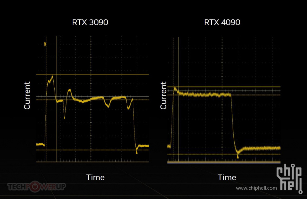

发表于 2023-7-26 14:07 来自手机 | 显示全部楼层
Lein 发表于 2023-7-26 10:56
请教下,40系瞬时功耗改善了很多吗 ?
https://www.google.com/amp/s/www.techpowerup.com/299096/nvidia-details-geforce-rtx-4090-founders-edition-cooler-pcb-design-new-power-spike-management%3famp
“In the chart above, NVIDIA shows how current spikes get mitigated by their new VRM design, which uses a PID controller feedback loop. While the RTX 3090 bounces up and down, the RTX 4090 stays relatively stable, and just follows the general trend of the current loading pattern thanks to a 10x improvement in power management response time. It's also worth pointing out that the peak power current spike on the RTX 3090 is higher than the RTX 4090, even though the RTX 3090 is rated 100 W lower than the RTX 4090 (350 W vs 450 W).”
应该是对vrm做了专门的优化
挖槽,这单卡可以一瞬间到那么高的功耗啊,太变态了
 楼主| 发表于 2023-7-26 14:16 | 显示全部楼层
实际上,2080Ti就已经出现过瞬时功耗过大导致电源自我保护的现象。当时主要是部分750w电源承受不住。
