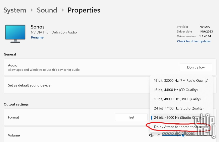

发表于 2023-8-31 15:39 | 显示全部楼层
noairhere 发表于 2023-8-31 15:37
我之前还点亮过 直连和通过电视 但是 这个软件杜比有时候还会掉 有时候还会直接破音 哪怕没有在播放声音  ...
转帖
Hello, I don't know if I can help you, but after searching and searching, it may be that the TrueHD (lossless) format of Dolby Atmos had to do with it. I could not play that format on my computer.
I have connected a Sonos Beam 2 Soundbar to the PC through the HDFury Arcana.
My monitor is Ultrawide and it seems that this is what was causing me a problem, because it seems that either the bar or the Arcana have to work with a certain screen resolution.
When I changed the resolution in my case to 1920 x 1440 in my case, Dolby Atmos for home cinema started to output sound.
To summarize, I would tell you to try changing the screen resolution to see if that is the problem.
I swear I was going crazy, and changing the screen resolution was the last thing on my mind, but I read something about that TrueHD format and they said that the solution was to change the resolution.
Also try disconnecting and reconnecting the soundbar's power supply. It sounds stupid but it works.
I hope it works for you.
