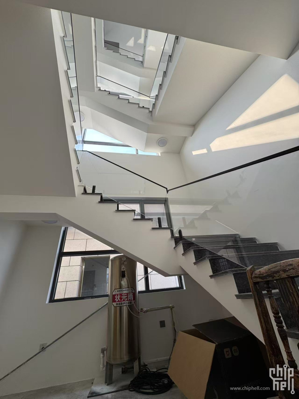

        坑点:楼梯是三跑,按照图纸规范折弯的地方(标高1.5和2.4的休息平台)都有梁,尺寸是240*300,但是并没有预留空洞,沟通后说是后续会凿半边墙放钢筋

大门厅
客厅(8.4*6.6)
三跑楼梯

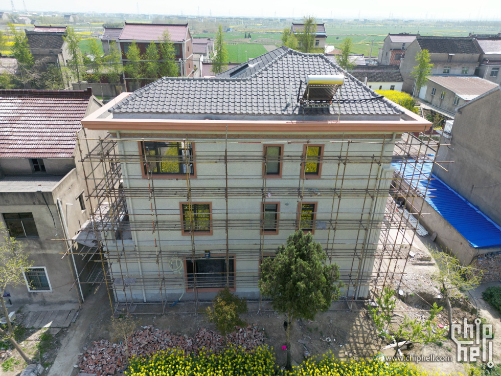

2025.04.06  过节回家,外墙完工(忘记拍晚上开了灯带的效果)
dji_fly_20250406_123954_377_1743914392034_photo.JPG dji_fly_20250406_123824_376_1743914392971_photo.JPG dji_fly_20250406_123812_375_1743914393890_photo.JPG dji_fly_20250406_123654_373_1743914396573_photo.JPG dji_fly_20250406_123636_372_1743914399016_photo.JPG dji_fly_20250406_123614_371_1743914400237_photo.JPG dji_fly_20250406_123552_370_1743914401269_photo.JPG dji_fly_20250406_123526_369_1743914402412_photo.jpg dji_fly_20250406_124126_378_1743914391026_photo.JPG
目前内部仅完成了吊顶,油工估计要秋天才能入场(红砖洒了太多水,用冲击钻打了孔,里面湿气还是太大)
