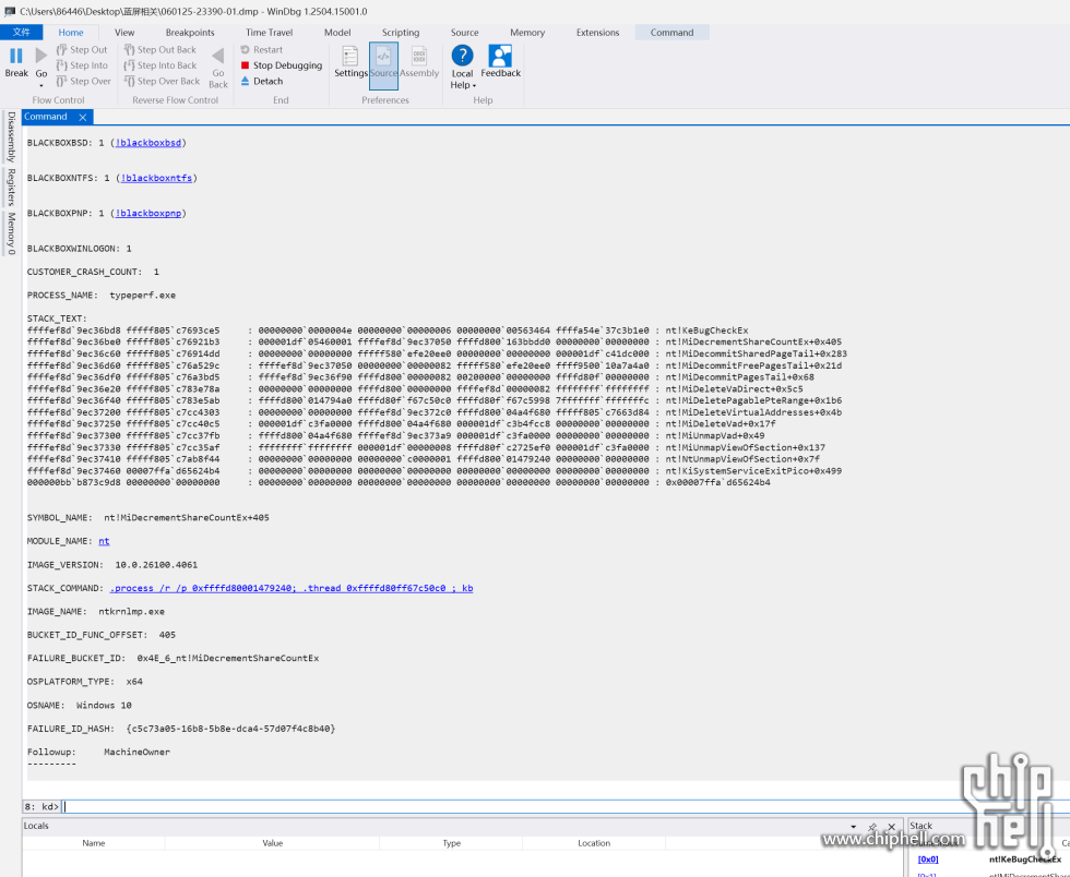

Windbg分析了dmp文件,错误代码4E,基本都指向内存
*                        Bugcheck Analysis                                    *
PFN_LIST_CORRUPT (4e)
Typically caused by drivers passing bad memory descriptor lists (ie: calling
MmUnlockPages twice with the same list, etc).  If a kernel debugger is
available get the stack trace.
Arguments:
Arg1: 0000000000000006, The hardware PTE and/or the prototype PTE PFN data structures have
        been corrupted.
Arg2: 0000000001331b2a, The page frame number
Arg3: ffff810302b57520, The prototype PTE
Arg4: e401480d26180460, The prototype PTE contents
BUGCHECK_CODE:  4e
BUGCHECK_P1: 6
BUGCHECK_P2: 1331b2a
BUGCHECK_P3: ffff810302b57520
BUGCHECK_P4: e401480d26180460
FILE_IN_CAB:  051425-21593-01.dmp
DUMP_FILE_ATTRIBUTES: 0x21008
  Kernel Generated Triage Dump
FAULTING_THREAD:  ffffe401707e60c0
BLACKBOXBSD: 1 (!blackboxbsd)
BLACKBOXNTFS: 1 (!blackboxntfs)
BLACKBOXPNP: 1 (!blackboxpnp)
BLACKBOXWINLOGON: 1
CUSTOMER_CRASH_COUNT:  1
PROCESS_NAME:  typeperf.exe
SYMBOL_NAME:  nt!MiDecrementShareCountEx+405
MODULE_NAME: nt
IMAGE_VERSION:  10.0.26100.4061
STACK_COMMAND:  .process /r /p 0xffffe4016c5760c0; .thread 0xffffe401707e60c0 ; kb
IMAGE_NAME:  ntkrnlmp.exe
BUCKET_ID_FUNC_OFFSET:  405
FAILURE_BUCKET_ID:  0x4E_6_nt!MiDecrementShareCountEx
OSPLATFORM_TYPE:  x64
OSNAME:  Windows 10

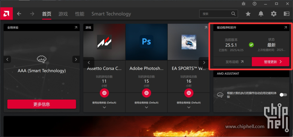

准备重装系统前瞄了一眼最近驱动,发现4月底AMD更新了一版25.5.1的驱动。。。。
DDU,退回老驱动,四五天过去了,没有再蓝屏过,难怪说要禁用自动更新驱动啊

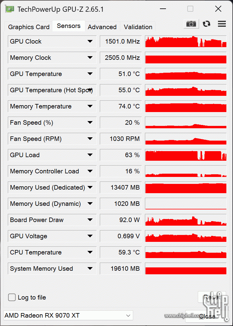

我魔兽世界一直显存溢出然后卡顿……以前6900XT没遇到过,现在16G显存不够用了

啊??魔兽世界吃显存??你确定排查了其他方面吗??

把AFMF关了试一下
