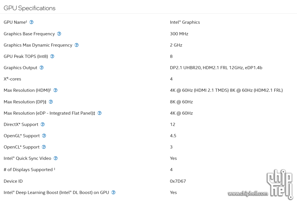

1x HDMI™
Support HDMI™ 2.1 with FRL, maximum resolution of 4K 120Hz*
2x Type-C DisplayPort
Thunderbolt™ 4 ports, supporting DisplayPort 2.1 with UHBR20 over USB Type-C, with a maximum resolution of 4K@120Hz / 8K@60Hz*
*Available only on processors featuring integrated graphics. Graphics specifications may vary depending on the CPU installed.

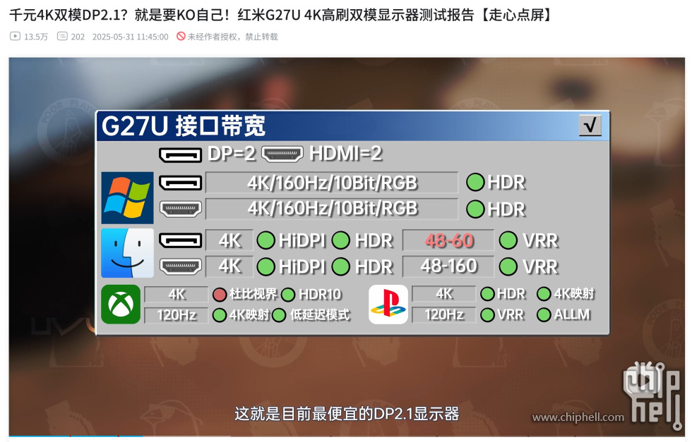

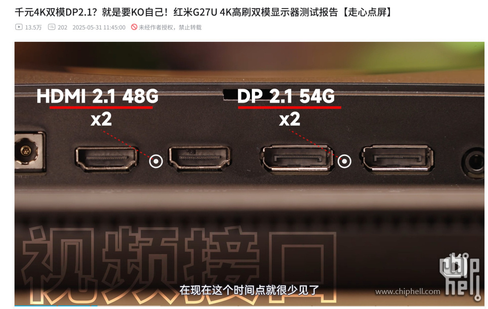

隔壁网友提到他的G27U HDMI能4k 160 10bit
官网提及DP 2.1 接口 54Gbps 带宽
https://www.bilibili.com/video/BV1ezjfzUE9E/
这个视频提到G27U HDMI和DP都能4K 160Hz 10bit RGB HDR

哥们intel规格写的清清楚楚max resolution hdmi支持4k60hz
 楼主| 发表于 2025-7-1 09:35 来自手机 | 显示全部楼层
那您是没看到规格后面还写着8k60hz吗?
