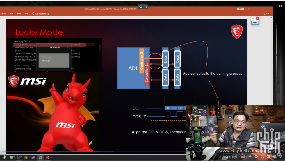

听到Zen6的这段IMC相关的传闻后一直觉得耳熟,今天突然想起来,似乎在Alder Lake上听过类似的概念。
查了一下MSI的讲解视频,发现AlderLake上就是双控制器架构,单个控制器单元只负责一个通道,单个控制器同时兼容DDR4与DDR5。
这种做法的好处是极大的提升了IMC的内存带宽,在12代上即使是DDR4的带宽也相比11代提升了25%。
看样子Zen6的CCD - IOD间带宽(这么描述的原因是还不确定是否继续叫IF总线)确实极大的提升了,足够IMC提升自己的读写能力。

发表于 2025-7-15 20:15 | 显示全部楼层
其实K10就有
https://en.wikipedia.org/wiki/AMD_10h
Two 64-bit independent memory controllers, each with its own physical address space; this provides an opportunity to better utilize the available bandwidth in case of random memory accesses occurring in heavily multi-threaded environments. This approach is in contrast to the previous "interleaved" design, where the two 64-bit data channels were bounded to a single common address space.
