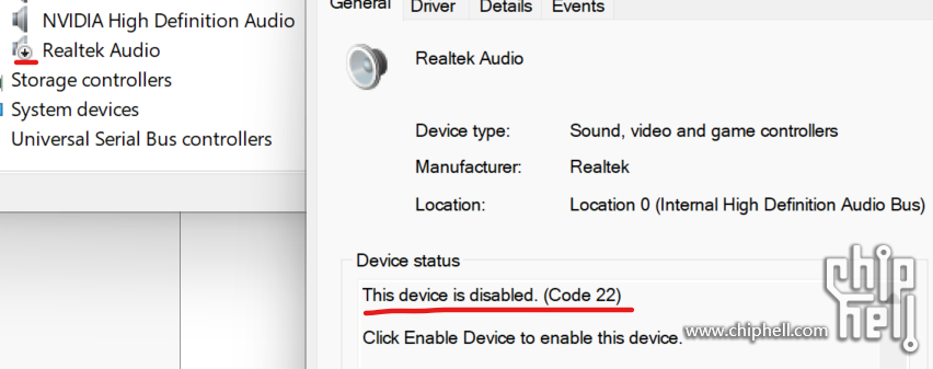

tiantian80 发表于 2025-7-17 08:51
显卡只是音频通道,你把板载声卡禁用掉就知道你用的是啥音频设备了
至少Chat**不认可您的说法。
When audio is output through the HDMI port of the graphics card, the audio is processed by the graphics card, not the motherboard.
Here’s how it works:
Audio source: The operating system (e.g., Windows) sends audio data to the audio device associated with the graphics card’s HDMI output. This is typically listed in the system as something like “NVIDIA High Definition Audio” or “AMD HDMI Output,” depending on the GPU manufacturer.
Audio transport: The graphics card has its own audio processing hardware, which takes the digital audio signal and encodes it into the HDMI stream along with the video signal.
Motherboard role: The motherboard is not directly involved in processing or transporting this audio signal. However, the CPU and system memory might still handle the application-level processing (e.g., decoding audio streams), but the actual delivery to HDMI is done via the GPU.
Summary:
Audio is processed by the graphics card when using its HDMI output.
The motherboard audio chipset is bypassed in this scenario.
Let me know if you want to see how to configure this or check if HDMI audio is enabled properly in your system.

你就不能试试把主板集成声卡禁用,看看能不能显卡输出音频?
发表于 2025-7-17 15:36 | 显示全部楼层
novagforce 发表于 2025-7-17 15:11
至少Chat**不认可您的说法。
发表于 2025-7-17 15:48 | 显示全部楼层
试了,能。
打脸不?要不您也去试试?
