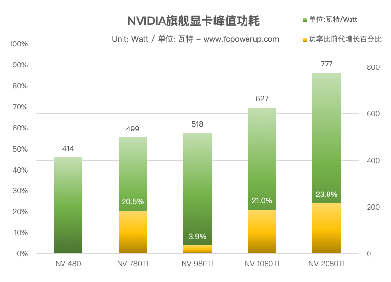

核弹也在升级啦离显卡功耗实标还有多远?峰值功耗与电源关系终结篇 – FCPOWERUP极电魔方
https://www.fcpowerup.com/end-gpu-spike-peakpower/#scroll-29
